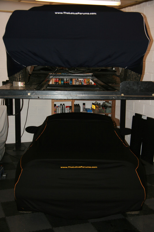

MPx Member Since: 29 Jul 2011 Location: South Somerset Posts: 601 ![]() ![]() ![]() |
Depending on your garage height, you may be better off with a 2 or 4 post lift. I put in a four post in 2008 mainly to use to double up parking, but its proven much more valuable over the years to allow me to mess with the cars in comfort and without danger. Mine was from InternBV in Holland, but the same design is widely available from others - usually a couple at the classic shows like at the NEC. Back then price was about £1500 but I think they're nearer £2500 now.

pld118 Member Since: 25 Mar 2013 Location: Bairns Posts: 4218 ![]() ![]() ![]() |
Great replies, thank you… would like a 2 or 4 post lift of course but don’t think would use it enough and don’t think our garage roof height is enough for one of those (on the cars yes but not the RR)… excellent big long and wide double garage but not the tallest ceiling height…. think a scissor lift or those ramps that you drive on to and hydraulic jack up might be the way to go… thoughts thoughts thoughts |
