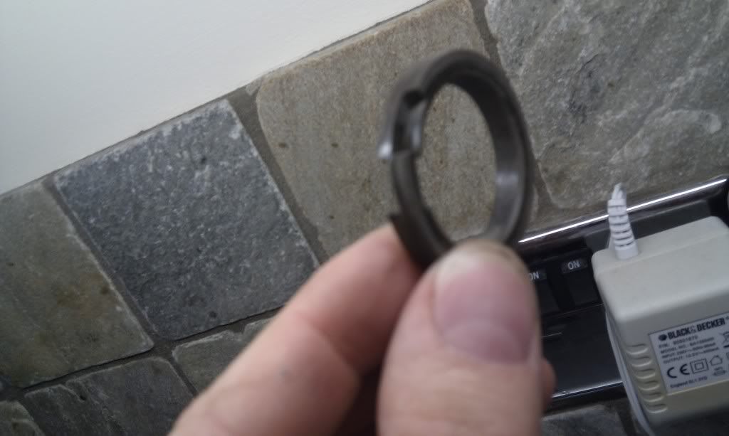

It would def be interesting to get the dimensions on a new ring as a comparison.

The black bit the same length of motor is the air drier, basically a cylinder with silca gel inside, nothing complicated. there is a thicker pipe going back to the suction (spillback). There are 2 funky valves solenoids. One of them is a normally closed and open when motor is running (to stop system draining out and to enable compressor to be changed and I think the other one releases the air out of the system when lowing vehicle.

Thanks Adam. That really demystifies things then. So the funky valves will be inlet/exhaust.

I've just given the compressor to our machine shop in work to see what he can do.

Those were exactly the reasons I said that it would be interesting to have the dimensions of a new ring and to do a compression test. If the ring is not what's causing the problems with your compressor then it has to be either inlet or outlet side. On the P38 compressors, the reed valves (if they are called that - 1-way inlet/outlet valves) have been know to fail. Air filter clear? Is the 'funky valve' switching properly? ![]() RRC 2Dr, RRC 4Dr, P38, and 2 L322s (wife thinks I'm nuts - prob right, too) |
swast4 Member Since: 07 Jan 2011 Location: Wirral Posts: 69 ![]() ![]() ![]() |
Yeh I know what you mean but it means forking out £330 for an experiment. The inlet valve on the compressor looked fine with no damage or contamination. Also the inlet filter is just a round metal gause on the compressor. Not the funky witches hat tap thing.

That's interesting about flipping the ring over. If only we knew what a new one looked like. My old compressor had a radius on the ring. Have you stripped your old/new compressor yet Adam? [img]http://www.fuelly.com/driver/rob2529/range-rover[img/]
Not got it yet, will experiment when I get it. That one of yours we havn't got a clue which way it was ? Is your cars stearing still good ? |
Rob2529 Member Since: 22 Nov 2010 Location: Wirral, uk Posts: 1470 ![]() ![]() ![]() |
I took it off the first time I stripped it an never noted which way it was. We could test it both ways? Obviously work is busy then! Lol. Steering is amazing! [img]http://www.fuelly.com/driver/rob2529/range-rover[img/]
